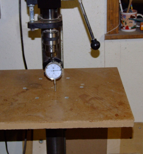

Some one was interested in hieght gages not long ago. Here is a very siple but accurate gage. I like it becuase I have a flat table to work off of.
I got this from the GAL latest issue I think.
Cost about $15

Hi Bruce Enco has them cheap, as does MSC.
Enco probably has the better price but both have offerings in the $15 range. I had that one, it's a cheap one and it matches up on reading with my Starett mic.
I like this set up because I get in the middle of the plate which I couldn't do with a mic or calipers.
I might note that the back can come of with 4 screws and you can rotate it if necessary so it's in the right orientation to chuck in you spindle.

Jim, you just made me bruise my forehead again! I've been putting off making a thickness gauge because it would be just another tool/jig that I don't have room for. Excellent solution, since the drill press is already there.
I can't see how you've got the dial chucked in, though. A bolt through the back hole?

You can undo the back of the indicator with the 4 itty-bitty screws and rotate it 90 degrees. Then can but a bolt in it and chuck up on that.
I'm actually chucked up on a shaft that goes with a mag base however.

Although I just commented "brilliant " , on reflection I can see a flaw. If the piece you are measuring has a dip on it's underside , it'll give a wrong reading of the wood thickness , measuring the dip as well as the wood thickness. Other units measure directly under the dial tip

You're absolutely right, but that problem can be corrected by drilling a small hole in the table then making a removable button with a rounded top to give a true thickness measurement.

I think it's a good idea not to have local divots in your top plates
But of course your right if you do have a little one on the underside you won't pick it up.
When I use it I apply light hand pressure to the top to remove any bow.

Actually, a carriage bolt works very well.  You might have to sand the lettering off the top of the head, but it makes a nice round surface.  If you wanted to elevate it, just put a wingnut above and below the table to hold it steady.

If you don't want to drill into your table for a bolt, you could buy or make a wood "button" and double-stick it under the gauge. Easy on, easy off.

That's a good idea for measuring non flat plates like archtops.
